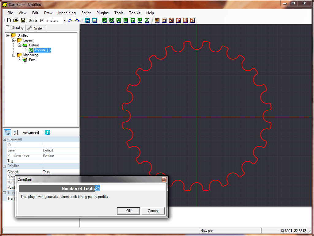

Step 1 - Insert an HTD timing pulley outline.
Use the new Plus Toolkit to generate a timing pulley by selecting the Toolkit - Timing Pulley menu item.
The plugin will prompt for the number of teeth for a 5mm pitch pulley, then insert a new curve with the center of the pulley about the origin.
ALT + double click will zoom the drawing to fit the view window.

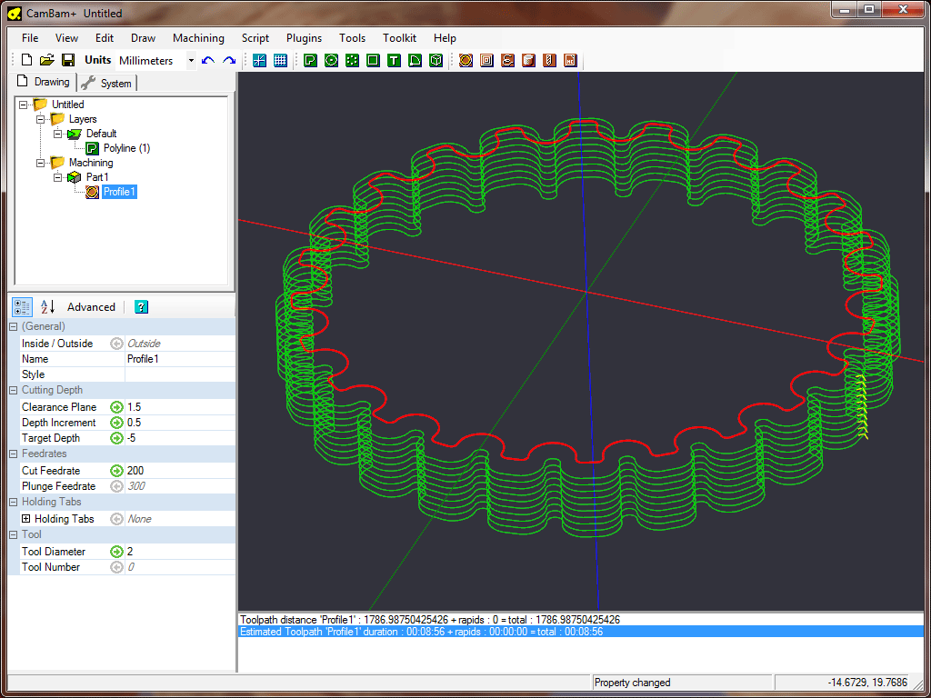

Step 2 - Insert a Profile machine operation
Select the pulley outline then click the Profile machining operation button
from the toolbar.
A new profile object will be created and displayed under the Machining folder in the drawing tree.
The object property window will display the profile's properties ready for editing.
Change the Profile machine operation's properties to the following:
| Tool Diameter | 2 |
| Depth Increment | 0.5
| Target Depth | -5 |
| Cut Feedrate | 200
| Plunge Feedrate | 100
| Clearance Plane | 1.5
Note: Some properties such as Clearance Plane may not be shown in the property grid.
Clicking the Advanced button at the top of the property grid will display all available properties.

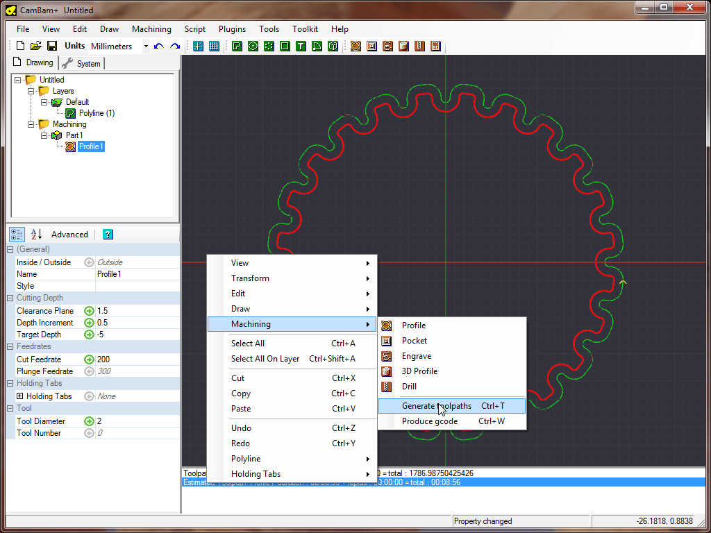

Generate the resulting toolpath for the profile; right click the drawing to bring up the drawing context menu, then select Machine - Generate Toolpaths.
To rotate the 3D drawing view, hold the ALT key then click and drag on the drawing.
To reset the view, hold the ALT key then double click the drawing.
Another rotation mode (Left_Middle) can be set in the Rotation Mode property of system configuration settings.
If this mode is selected the view can be rotated by clicking the middle mouse button and dragging with the left.
To reset the view in this mode hold the center mouse button and double click.

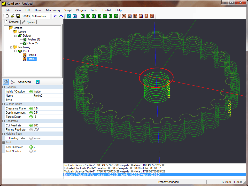

Step 3 - Creating the inner hole
First draw a circle using the circle drawing tool
with the center on the origin with Diameter = 8.
Select the circle and insert another profile machining operation
Set the target depth and other properties to match the first profile operation.
Hint: A quick way to do this is to select Profile1 and copy it to the clipboard
(using the context menu or CTRL+C). Then select Profile2 and use the Paste Format command from the context
menu shown when right clicking Profile2, or use SHIFT+CTRL+V.
Change the Inside / Outside property to Inside.
Again, right click the machine operation in the file tree and Generate Toolpaths.

To create a gcode file (post), right click to get the drawing menu then select Machine - Produce GCode.
CamBam will then prompt for the location of the gcode file to produce.
