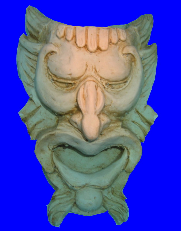

Step 2 - Select a Bitmap File.
The success of a Heightmap depends largely on the quality of the source bitmap. Front lit objects with even shading usually work best.
Inspired by the inimitable greybeard's experiments in the cnczone 3D for Crazies thread,
I photographed an object submerged in a tray containing water and blue food colouring. I then used a drawing program to filter the bitmap to
just show the red channel as a greyscale image. In theory, the further the item is from the surface of the liquid, the more blue it will appear.
This worked much better than I expected although care must be taken to avoid surface reflections and air bubbles. This is perhaps not such
a good idea for making heightmaps of people.

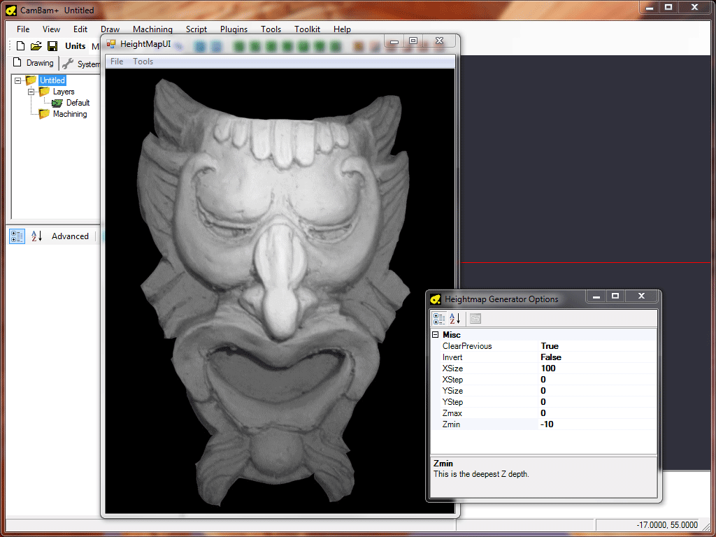

With the Heightmap generator window open, select File - Open from the top menu and select the source image.
Step 3 - Heightmap Options
Change the heightmap options from the Heightmap plugin's Tools - Options top menu.
Here is an explanation of the properties

Step 4 - Generate Heightmap
Close the options window and select Tools - Generate Heightmap.
You should see some lines appear in the underlying CamBam drawing. Leave the Heightmap generator window open and rotate and scale the CamBam drawing to get a better idea of the Heightmaps dimensions.

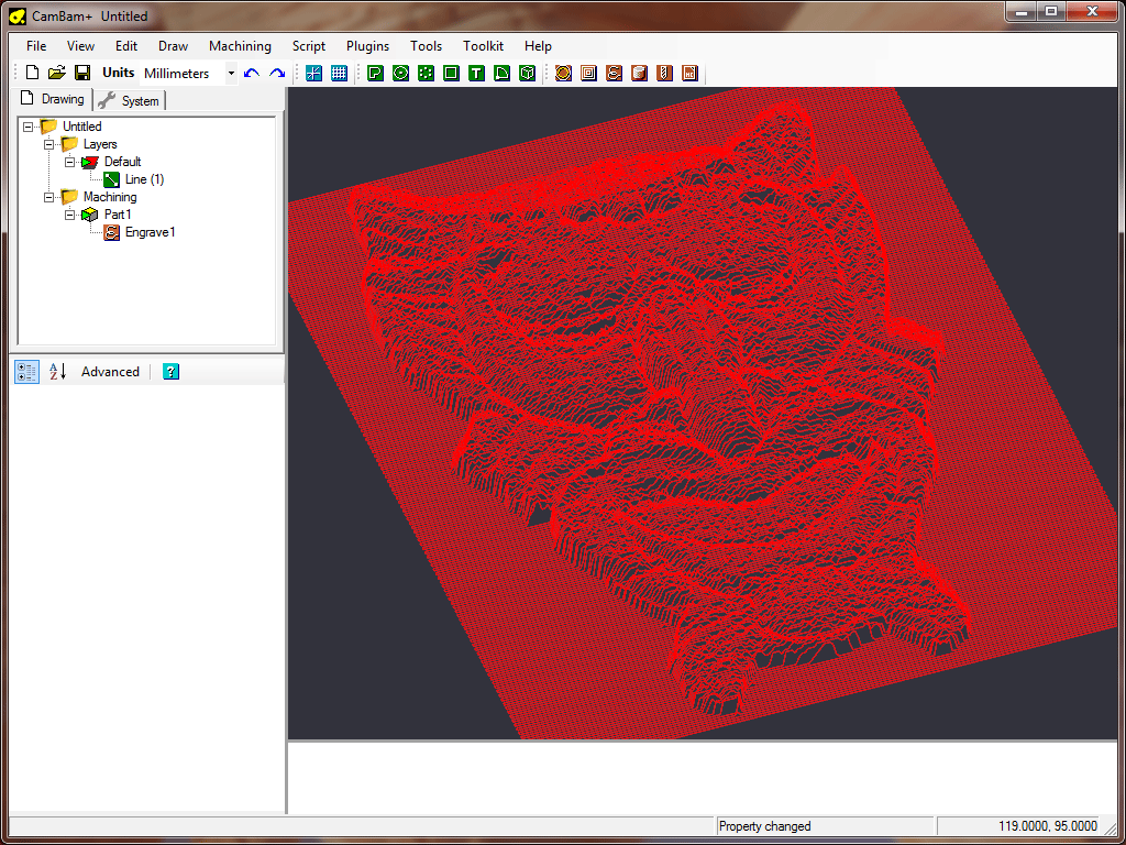

Here is a screenshot of the resulting heightmap.
As well as generating a 3D Line object that contains the resulting heightmap, the plugin also creates an engraving machine operation linked to this line. An engraving operation is used as these are designed to 'follow' the associated geometry. In effect it is using the 3D line as a toolpath.
Change the Engraving machine operation parameters such as cutting feedrates.
NOTE: Do not change the engraving target depth value, the cutting depth is taken from the source line.
To convert the heightmap into gcode for your machine, right click the Machining group in the CamBam tree view then select the Create GCode File menu option.

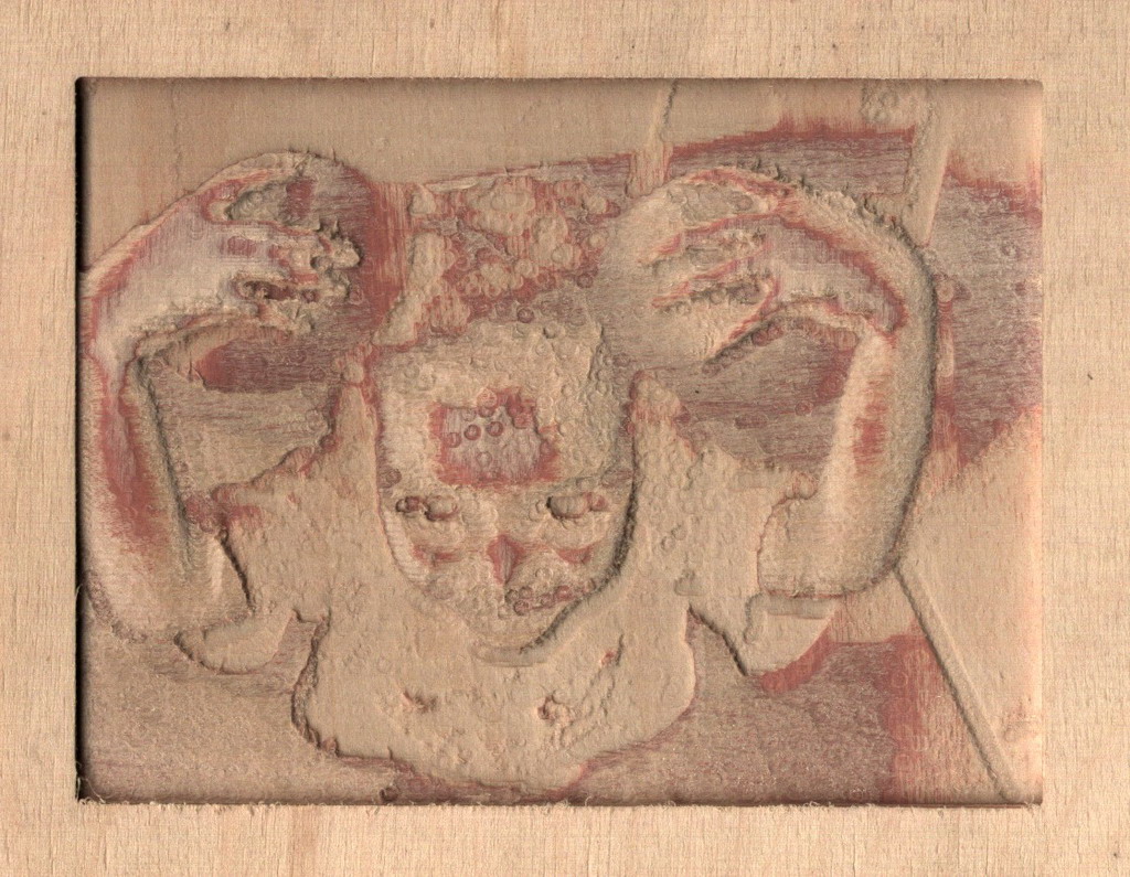

Here is the very first Heightmap I produced from CamBam. The image is 120mm X 90mm using a 2mm flat bit in plywood. Not fantastic to look at but at least there were no disasters.
I will try to find some nice examples.

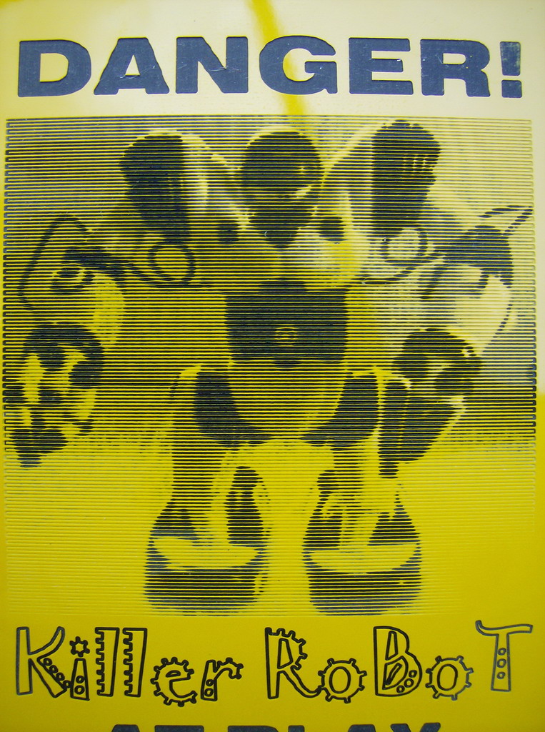

Photo Engraving
The heightmap process can also generate shaded engravings from bitmaps.
A V cutter is used, usually into a 2 tone engraving laminate. The deeper the cutter, the wider the cut and darker it will appear (if using a light on dark laminate).
The Z depth needs only be small (~0.5mm, 0.02in). The YStep stepover should be increased so the 'scan lines' do not overlap
and spoil the shading effect. This distance will vary depending on the V cutter angle and depth. For a 60 degree cutter at 0.5mm
I use a 0.7mm YStep.

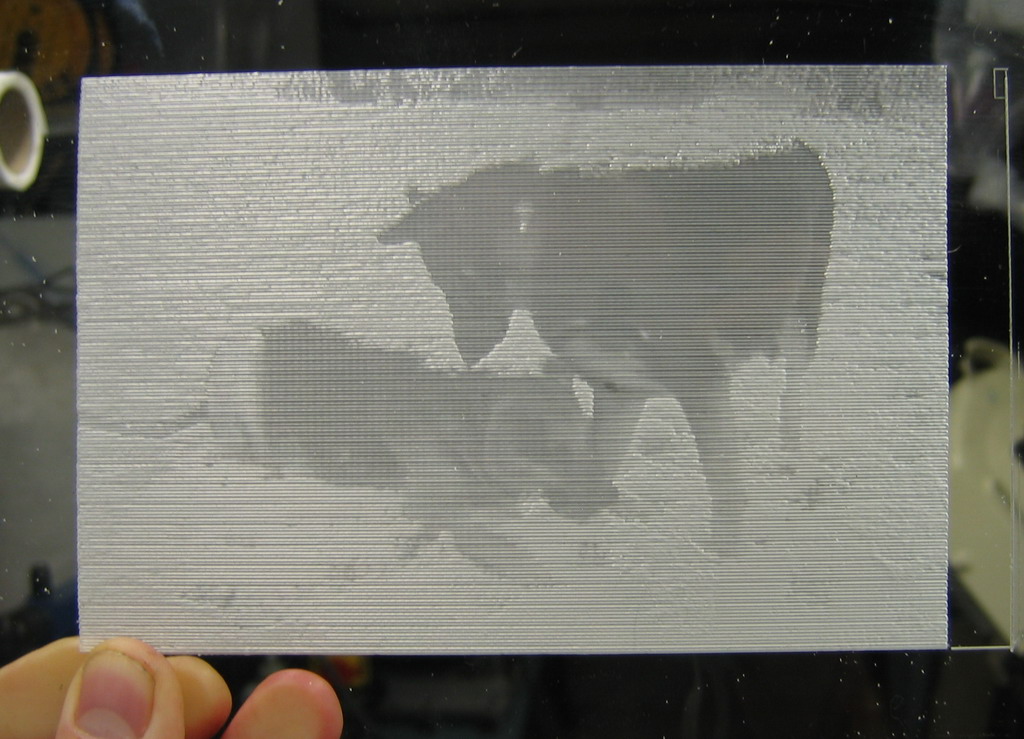

A lithopane is another variation on this theme, where an image is engraved into a thick translucent material and viewed with back lighting. Lithopanes are typically inverted with the deeper cuts
resulting in thinner material and more light shining through.

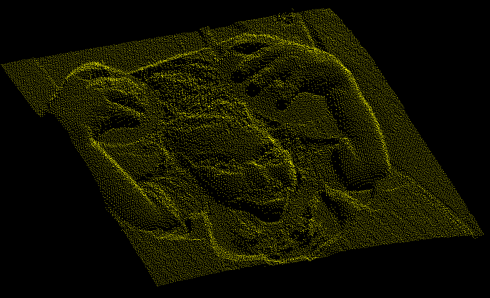

Creating a Point Cloud From a Heightmap
Here is a method to generate a DXF point cloud
Generate a heightmap polyline as per usual and select the line if it is not already.
Now do Draw - Point List - Step Around Geometry. from the drawings context menu.
This will insert a point along the line every N step distance.
By default, the heightmap will do 1 bitmap pixel = 1 drawing unit (This can be changed in the heightmap options).
I entered 1 for the step distance then pressed OK.
CamBam currently displays points using biggish squares so it will look cluttered, but don't worry about that.
The line object can now be deleted.
The drawing can now be exported to a DXF file. Here a heightmap pointcloud is viewed in AutoCAD.
