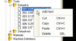

Managing tools
Like the other system libraries, new tools and tool libraries can be create from the context menus presented
when right clicking the system tab's
Tools folder and tool library sub folders.

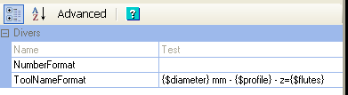

Tool numbering and naming
Tools can be re-numbered by simply changing their index number in the property grid. If the number entered already exists, the numbers of the following tools will be staggered.
It is also possible to automatically rename using an expression entered into the tool libraries Tool Name Format property.
The expression can contain the following macros:
{$diameter} = Tool diameter
{$profile} = Tool shape / profile
{$flutes} = Number of teeth / flutes
{$index} = Tool number
{$length} = Tool length
{$veeangle} = Tool Vee angle
The tool name will be recalculated whenever the tool properties have changed. It is also possible to rename all the tools if the format expression has changed
by using the Rename all tools from the tool library context menu.
The following image shows the tools renamed using the following format expression.
{$diameter} mm - {$profile} - z={$flutes}
