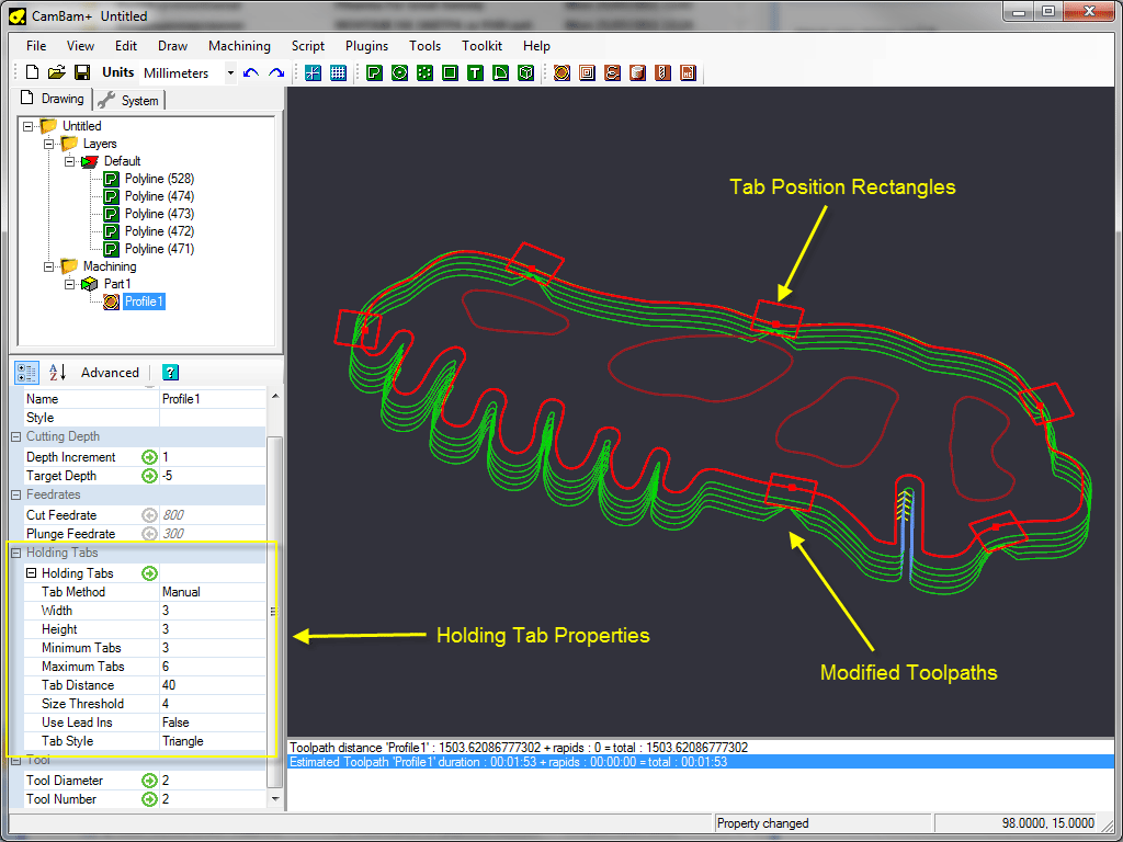

The holding tabs will be displayed as a series of rectangles spaced around the source drawing shapes.
If the automatically generated holding tabs are in inconvenient positions, they can be quickly moved by clicking
and dragging them to an alternate position. This will also change the Tab Method to Manual.

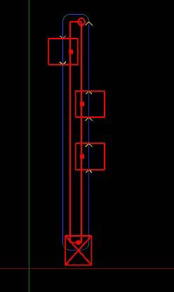

If a tab is displayed with a red cross marker through it, this indicates a holding tab that cannot be applied to
any toolpaths. This is often caused when holding tabs are positioned on the corners of shapes. In these cases,
manually adjusting the tab position will resolve the problem. The X marker will not be cleared until the toolpaths
are regenerated.

The number and spacing of the automatically generated holding tabs is controlled by the Tab Distance
parameter as well as the Minimum and Maximum Tabs properties. For example, if the perimeter of
an object is 160mm and a tab distance of 30mm is used, the nearest whole number to 160/30 ie 5 holding tabs
will be considered. If however this number is greater than the Maximum Tabs property, the maximum
tabs number will be used instead. Similarly, if the automatic number of tabs is less than the Minimum Tabs property,
the minimum number will be inserted.
If Tab Distance is set to 0, the minimum number of tabs is always presumed.

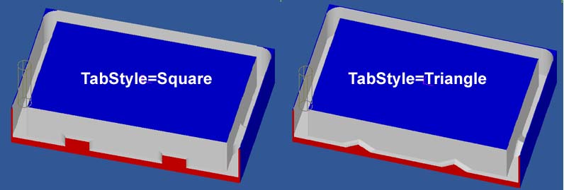

There are two types of holding tab cross-section shapes available which is defined in the Tab Style property:
Square and Triangle. Triangles are a good all-round tab shape, easy to clean up and provide a degree
of ramping back down into the stock. Squares can be stronger and can also be used with lead in moves when Use Lead Ins
is set true. This is useful for holding tabs in harder materials.

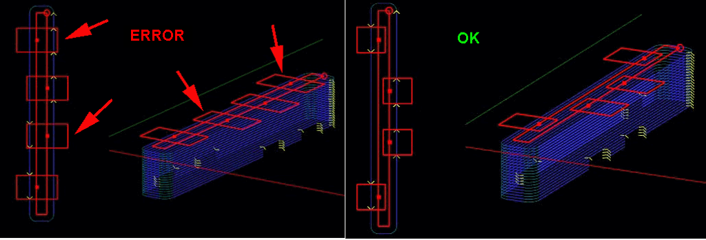

In some cases, such as very narrow source shapes, a problem can occur where the shape of the holding tab may extend to the toolpath
on the other side of the part and holding tabs incorrectly assigned to the wrong side.

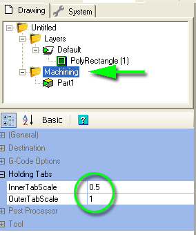

To help resolve this problem, two parameters are available in the Machining properties of the drawing: Inner Tab Scale
and Outer Tab Scale. These are used to extend or contract the size of the tab 'rectangle'. The inner tab scale will alter
the size of the tab rectangle that extends towards the source shape. The outer tab scale will affect the tab size away from the stock shape.
The following image show a narrow source shape that has caused an incorrect holding tab. Reducing the inner tab scale resolves this problem.
