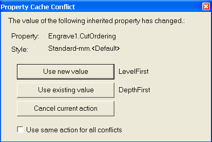

Property cache conflict alert
 If the result of a Default property has changed from the previous value used, a Property Cache Conflict message may be shown.
This may occur if the value stored in the parent style has changed, or if the style uses an Auto value and parameters
that affect the result of the automatic calculation have changed.
The warning message provides the following options:
- Use new value - the newly calculated default value will be used.
- Use existing value - the old value will continue to be used.  This will change the property from a Default to an explicit Value.
- Cancel current action - the old value will continue to be used and left as a Default, but the current action will be cancelled.
If Use same action for all conflicts is checked, the same response will be used whenever a new conflict is detected.
This remains in effect until the file is closed.  The next time the file is opened, changed default properties will once
again be reported.
The cache conflict alert was added to prevent inadvertent changes to a drawing resulting from changing a style or
other dependent system library.  In this way, if a drawing is transferred to another computer or sent to another person,
it is not necessary to also provide the dependent style definitions, as all the required information will be preserved within the file.

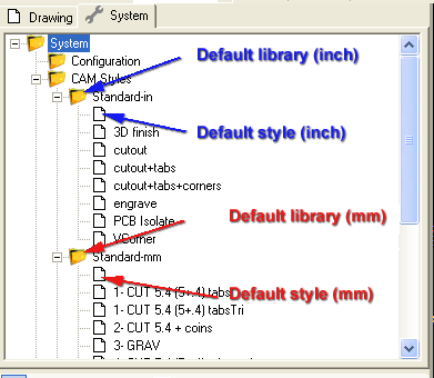

In the event that no style is defined at any of these levels, the default style will be used for the source of the Default values.
.png) The default style is the style with an empty name in the style library.
Warning: The default styles are very important for CamBam to function correctly and should not
be renamed or removed.

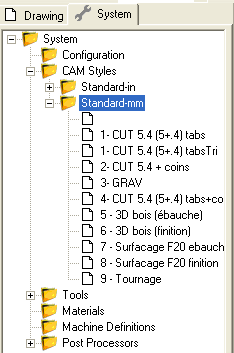

Style definitions and style libraries
Style definitions can be maintained from the CAM Styles section of the System tab.
CAM Styles contain a Parent Style property, so that styles can be based upon other styles.
If the parent style parameter is not set, the default (blank name) top level style will be used to resolve default properties.

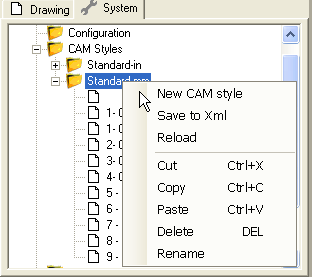

 Styles and style libraries can be cut, copied, pasted, deleted and renamed within the System tree.  A right click context menu gives access to many of these commands.
Styles can also be moved from one style library to another by clicking and dragging them within the system tree.
If a style library has been modified externally or by another instance of CamBam, the Reload operation will load the latest changes into the current program instance.

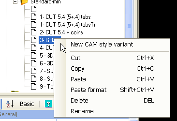

 The context menu shown when right clicking a style also contains a New CAM style variant option.  This will create a new style that inherits its default
parameters from the selected 'parent' style.
It is also possible to copy settings from machining operations into a style by copying the machining operation to the clipboard, selecting the
system tab, right clicking a destination CAM style then selecting Paste format from the context menu.
This provides a similar functionality to the Copy MOP to Template operation of previous CamBam versions.
