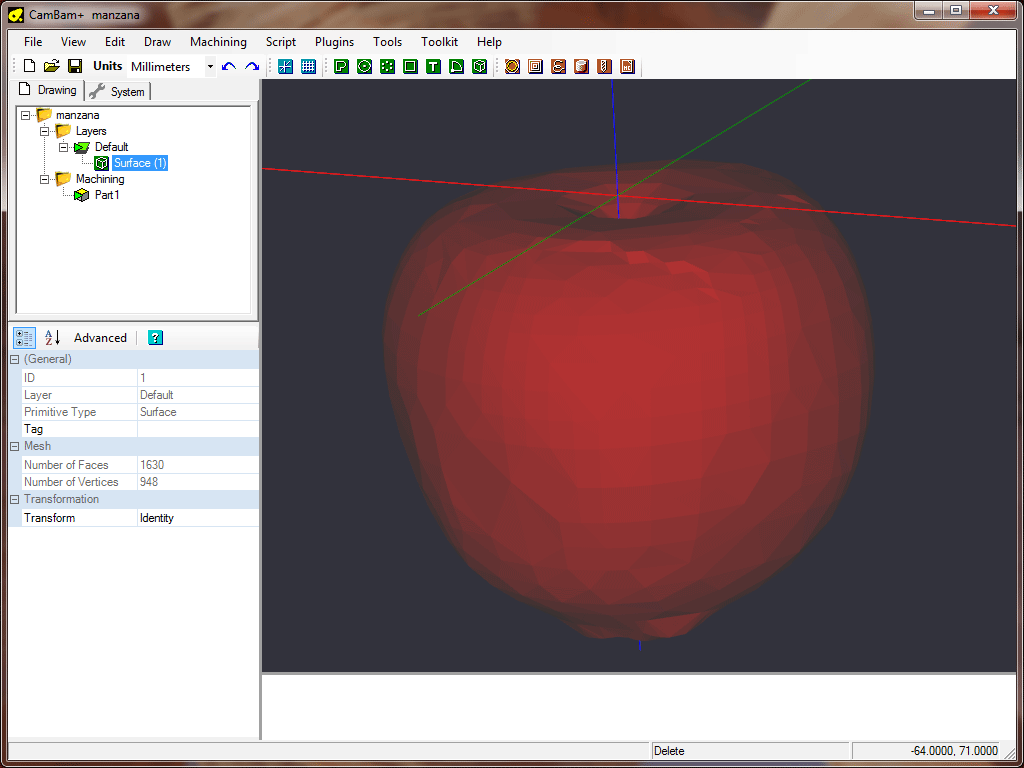

Loading 3D models, sizing and positioning
Loading
CamBam currently can read .3DS file, .STL and .RAW 3D mesh files. These can be loaded using the File - Open menu option
or by dragging files onto the CamBam drawing window.
If an imported object is not immediately visible, it may be because its default dimensions are very small compared to the
currently display stock object. If this is the case, temporarily hide the stock using View - Show stock, then use
View - Zoom to fit.

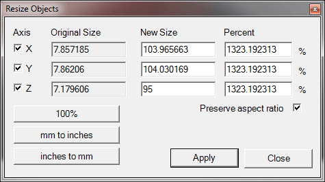

Sizing
To make the model a fixed size, the Transform - Resize command can be used.
This will open the Resize window which will show the existing object dimensions and allow them to be resized to a specific
dimension, or by a scaling percent.

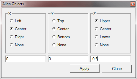

Positioning
Transform - Align can be used to position selected objects. This will display a form with 3 columns, one
for each axis. Select the point of the selected axis to align, or none to leave the current axis position intact.
Enter the drawing coordinate underneath which will be the new location of the alignment point, then press Apply.
For example, to position an object so that it's lower left corner is at the drawing origin and the highest Z point is
just below the stock surface (if using Z=0), use the following alignment values:
X - Left, Value = 0
Y - Bottom, Value = 0
Z - Upper, Value = -0.5
It may be more convenient to reference the machine's Z=0 to the work table, then use a Stock Surface value that is the Z height of the stock.
This works well when the stock used has an uneven surface or is difficult to reference a tool to (particularly after a roughing pass).
This can also simplify back face machining. If using this method, use the following Z alignment options:
Z - Center, Value = 0

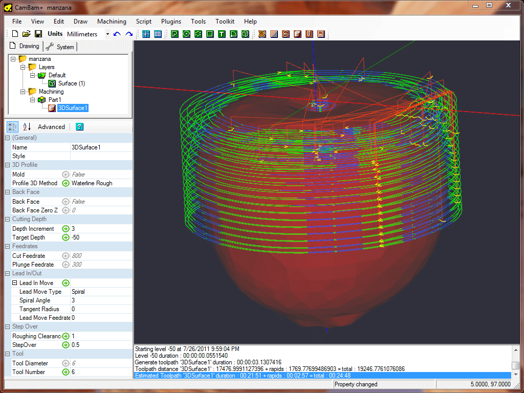

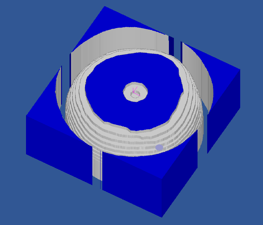

Front face waterline roughing
Waterline roughing is an efficient way to clear the bulk of the stock around the 3D model.
Create a 3D Profile operation
Select the 3D surfaces to machine, then insert a 3D Profile machining operation (Machining - 3D Profile)
or select the
icon from the toolbar.
If a Stock object has been correctly defined, some properties may be automatically calculated, such as Stock Surface and Target Depth,
as the default CAM Style has these values set as Auto values.
Basic Properties
Note: dimensions shown here are metric.
| Property |
Value |
Notes |
Profile 3D Method
Waterline Rough
Depth Increment
3
The maximum Z depth per cut of each machining layer.
Lead In Move
Spiral
3 degree
As well as making life easier for the cutter, this also gives the Fast Plunge Height behaviour a reference point which
helps avoid slow plunges.
Roughing Clearance
1
Leave a small amount of stock to be cleared away in the finishing pass, to avoid waterline machining marks being visible.
Stock Surface
0
In this example, Z=0 is referenced to the stock surface. |
Target Depth
-50
If the model is 100 units tall, this will machine the top half of the model.
Tool Diameter
6
To increase roughing speed, use a larger tool.
Tool Profile
End Mill
Scanline (horizontal /vertical) and waterline finishing methods will adjust tool paths for bull/ball nose cutters.
For waterline roughing operations, the tool profile does not affect the tool path.

This image shows the waterline roughing toolpaths

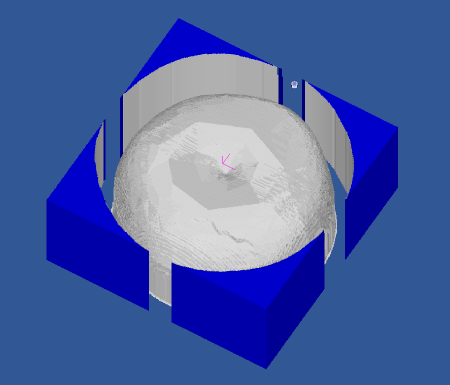

Simulation of the roughing pass in CutViewer Mill

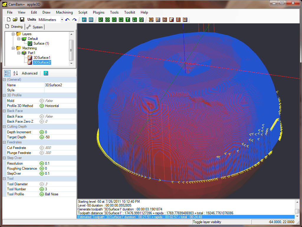

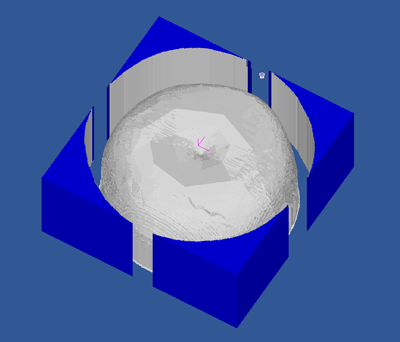

Scanline finishing
Once the bulk of the material has been cleared by roughing, a scanline finishing pass can be applied.
Select the 3D surface and insert a second 3D Profile operation.
This time, set the Profile 3D Method to Vertical or Horizontal.
To attain a finer finish, with less toolmarks, a horizontal pass followed by a vertical finishing pass can be used.
Basic Properties
| Property |
Value |
Notes |
Profile 3D Method
Horizontal or Vertical
Depth Increment
0
Depth increment should be 0 to do a single finishing pass.
Target Depth
-50
Use the same target depth as the roughing pass.
Roughing Clearance
0
No roughing clearance - will clear off clearance stock from the roughing pass.
StepOver
0.1
Distance between toolpaths expressed as a fraction (0-1) of the cutter diameter.
Smaller stepovers will give a nicer finish but take longer to machine.
Resolution
0.1
This is the distance along toolpaths expressed as a fraction (0-1) of the cutter diameter, at which the height of
the model is tested.
0.1 should be adequate, but a smaller value could be used if inaccuracies occur (especially around
small features or perpendicular edges).
Tool Diameter
3
A smaller tool will result in more detail but takes longer to machine.
Tool Profile
Bull Nose
The horizontal and vertical scanline, as well as waterline finish, methods will adjust tool paths for ball nose cutters. |

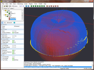

This image shows the scanline finishing toolpaths
The finishing pass simulated in CutViewer Mill
