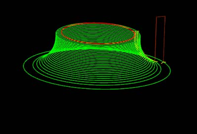

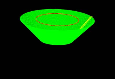

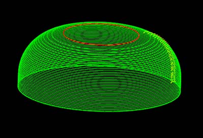

Method=CovexRadius, Value=+Ve, Profile=Outside

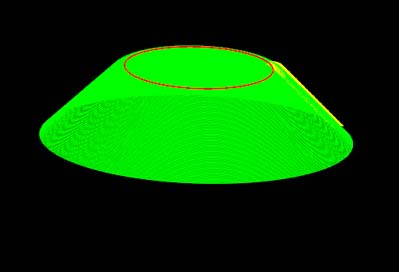

Method=CovexRadius, Value=-Ve, Profile=Outside

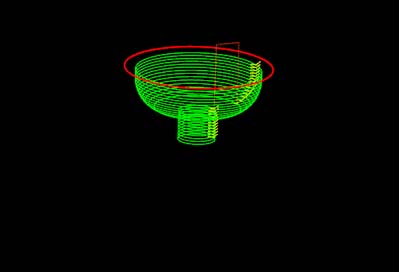

Method=CovexRadius, Value=+Ve, Profile=Inside

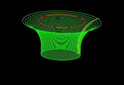

Method=CovexRadius, Value=-Ve, Profile=Inside

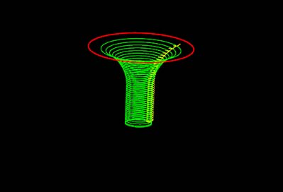

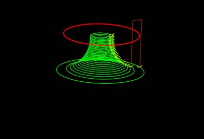

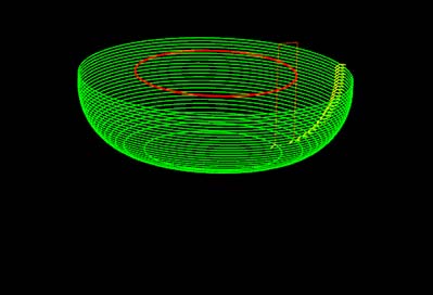

Method=ConcaveRadius, Value=+Ve, Profile=Outside

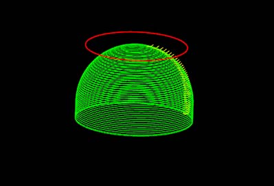

Method=ConcaveRadius, Value=-Ve, Profile=Outside
Method=ConcaveRadius, Value=+Ve, Profile=Inside
Method=ConcaveRadius, Value=-Ve, Profile=Inside

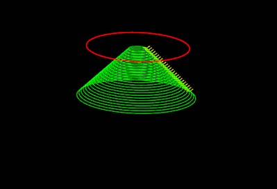

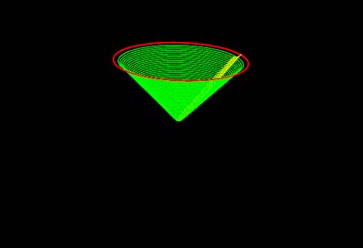

Method=Slope, Value=+Ve, Profile=Outside
Method=Slope, Value=-Ve, Profile=Outside
Method=Slope, Value=+Ve, Profile=Inside
Method=Slope, Value=-Ve, Profile=Inside
