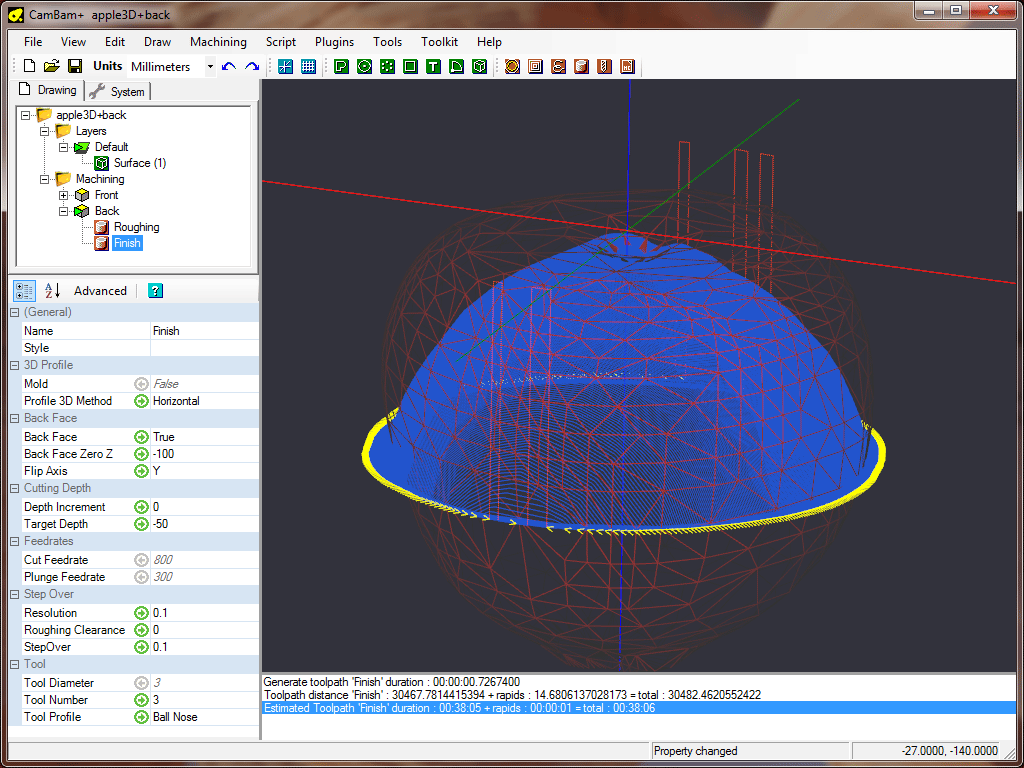

Back Face
True
Back Face Zero Z
0
In this example, the table surface Z=0 is used, so the model is rotated about Z=0 to machine the back face.
-100 |
In this example, the stock surface Z=0 is used, the model is around 100 units tall and is aligned so that the highest
Z point is at or just below the stock surface (Z=0).
Flip Axis
X
The stock will be rotated around the X axis (top to bottom), when the back face is to be machined.
Y
The stock will be rotated around the Y axis (left to right), when the back face is to be machined.
The back face toolpaths will be displayed in the orientation they will be machined, which may overlay the top face of the surface.
Hiding the drawing layer containing the 3D surface, or setting wireframe view mode makes viewing the toolpaths easier.

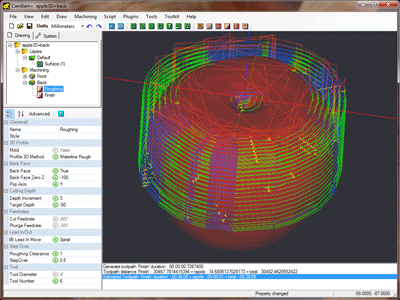

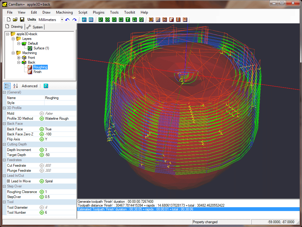

Back face roughing toolpaths

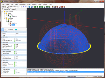

Back face finishing toolpaths (with wireframe view)

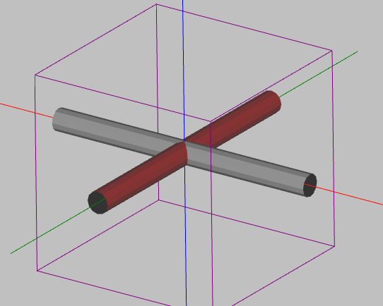

Here is a method to manually create 3D holding tabs or sprues using cylinder meshes.
Extrude a circle
Hide the drawing layer containing the 3D mesh.
Create a new layer to contain the holding cylinders ('tabs').
Draw a 2D circle with a diameter of the holding tabs to be used. Place the center of the circle at the drawing origin (0,0).
With the circle selected, select Draw - Surface - Extrude. Enter an extrusion height large enough to span the largest width
of the model plus an extra margin to allow for tool diameters. Enter the number of extrusion steps or facets around the extruded mesh to create.
Rotating the drawing view should show a 3D cylinder extending in the positive Z direction.
Position the cylinder
First, center the cylinder (Transform - Center (Extents))
Use a combination of cut and paste and transformation rotations to position the cylinders at required positions around the model.

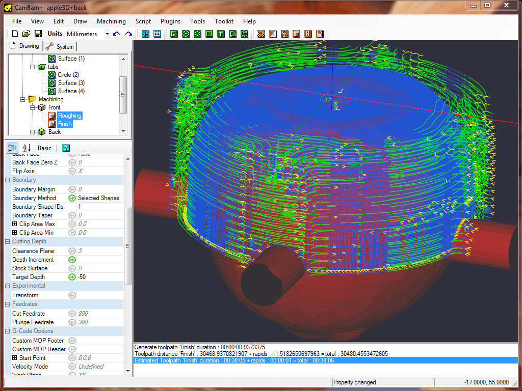

Adjust the machining boundary
The holding tab shapes need to be added to the 3D profiles list of surfaces to machine. To do this, right click on the machining
operation in the drawing tree and select Select Drawing Objects. Ctrl+click to select the extruded cylinders.
To prevent the machining operation machining around the ends of the cylinders, we need to reduce the boundary shape.
This is achieved by specifying Selected Shapes in the Boundary Method property and selecting only the main surface object,
excluding any holding tab cylinders.

Front roughing toolpath with manual holding tabs.
