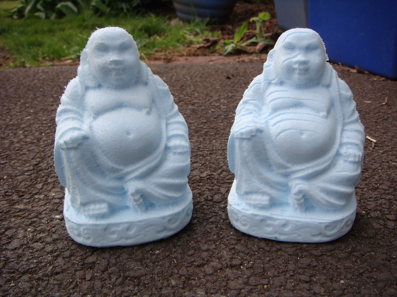

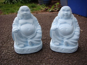

The left hand buddha was finish machined at 2000mm/min resulting in a fuzzy finish (but total run time was only 45 minutes including a 3mm depth roughing pass
and 0.3mm finish stepover). A faster spindle speed should have been used for the finish. The right buddha
had a slower finish speed but the tool was referenced incorrectly resulting in roughing gouges. Practice makes perfect!
These files were made from a 1.5M face model from the wonderful Aim@Shape Shape Repository, down-sampled
to 30K faces using the equally marvelous MeshLab application.

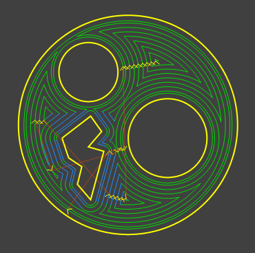

Draw - Fill Region
Region fillers are another development added to support the new 3D profiling routines and useful in other applications.
Region fillers are used to fill a shape with lines according to certain patterns. The lines can the be used to form tool paths
(as with 3D profile waterline roughing).
Once the technique has been proved with waterline roughing, the intention is to change the existing 2D pocketing operations
to use these routines.
The current region filling styles are:
- Inside Offsets region filled with offsets from islands radiating outward.
- Outside Offsets region filled with progressive offsets from outside in (like current pocket method).
- Inside + Outside Offsets region filled with progressive offsets from outside in, unioned with offsets from islands radiating outward.
- Horizontal Hatch region filled with horizontal lines
- Vertical Hatch region filled with vertical lines

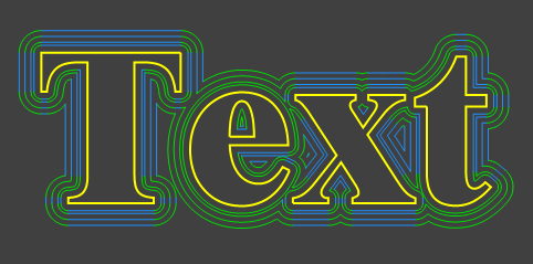

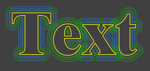

Toolpath collision detection (unioning)
I think the best way to describe this feature is with some pictures...
Toolpaths for shapes close together would overlap in previous versions, resulting in overcutting
With collision detection, all toolpaths are unioned together, avoiding overcutting.
Another use for collision detections is for inside profiles for regions. This provides an alternative method for island pocketing which
requires no 'clean up' pass around inner islands. This will be added as an extra option to pocketing operations.
This new feature also makes it possible to do better isolation routing files for printed circuit boards as previously increasing cut widths would over cut tracks.

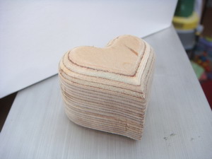

Side Profiles
Side profiles are a new feature available in 2.5D profile machine operations, though their use will soon be extended to pockets and 3D profiling.
They allow 3D effects from 2D shapes by specifying a profile shape for the cut face.
Side Profile properties are defined in the 'Misc' section of the profile's machining operations properties. Similar to holding tabs and lead ins, this property requires expanding
by clicking the '+' plus icon to the left of the property.
| AdjustCutWidths | A better description for this property might be 'Roughing or Finishing'
When True, all layers above a profile cut are also cut.
When False, only the side profile shapes are cut. |
| Method | The shape of the profile cut. Options are...
None - Turns off side profiling and uses normal verticle cuts.
Slope - The cut face is a straight slope or bevel with Value the angle of the slope in degrees from the verticle.
ConvexRadius - The cut face is an outer radius with Value the radius of the curve.
ConcaveRadius - The cut face is an inner radius with Value the radius of the curve.
| Value | This number is used as a parameter for the selected profile shape. |
The sign of Value is significant and changes the behaviour of the side profile.
The samples folder contains a file 'side profiles.cb' which shows an example of all the permutation of side profile methods, value signs and inside / outside profiles.
Another example 'heart-shaped-box.cb' is also provided which uses side profiles.

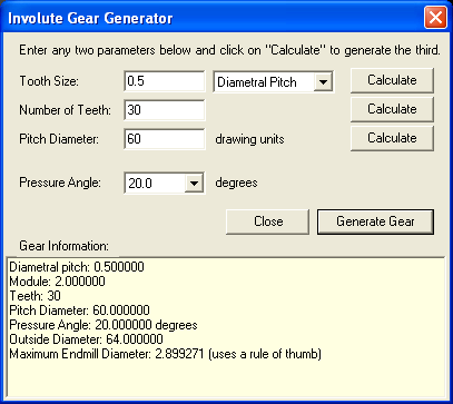

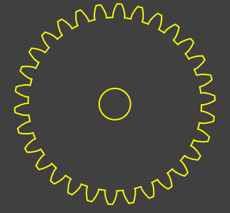

Involute Gear Plugin
With many thanks to Ajayre the CamBam plus toolkit now contains an involute gear generator. This is available under the 'Toolkit' top menu.
