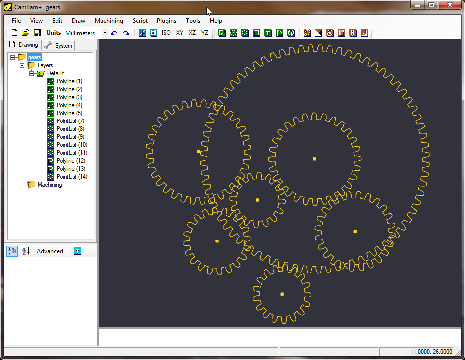

This script takes a pre-drawn group of gear outlines (generated using the CamBam gear generator), then animates them using a series of relationship rules within the script.
This script requires CamBam 0.9.8N or later.
This script demonstrates:
  • Importing a helper Python module.
  • Defining a Python class.
  • Animating objects by changing their transformation property.
Gear animation
Source
Download
This download also contains the example CamBam drawing required by this script.
gear-animate-source.zip (89 KB)
