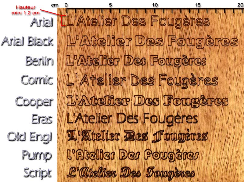

« Reply #38 on: November 11, 2010, 22:59:52 pm »
Hello,
some tests with fonts on plywood
David
