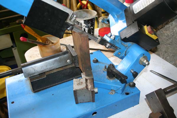

dave benson
Posts: 1044
View Profile
« Reply #74 on: July 31, 2018, 03:04:25 am »
That's a good idea, I'll keep that in mind Bubba, looks pretty sturdy to me. You've planted an idea here and I'll keep an eye out on the auction sites and if I can find one cheap enough.
 David, I think your saw looks similar in size to the saw I looked at (the $650 one) although that one looks  better made. Wish I had your lathe.
I see  both of you have your stock orientated vertically, this was my want too, but this little  saw won't accommodate this, so I had no choice but to lay the stock at an angle. About 60 deg.
Which gives about 40 mm of teeth in the cut.
This is not ideal as due to the minimalistic design of the saw, the crank angle relative to blade holder changes from the bottom to the top of the cut, in practice what this means is that at the start of the cut you need a little more pressure on the blade to make it cut properly ( I made a collar that fits onto the front of the blade handle) on the other hand at the bottom of the cut the blade dig in more and some weight would have to be removed.
Too try to remedy this, I attached a Parker air cylinder (40mm dia) and a flow control with integrated check valve to the hacksaw arm and filled it with compressor oil, it took ages to bleed properly.
I added some weight to the hacksaw arm so now I can get reasonable regulation of the cut by starting the cut and then adjusting the control valve and listening to the sound of the cut.
The only problem is that the system bleeds down at about 2/3 of the cut depth, so at about half way through the cut, I stop the saw and re-prime the cylinder by lifting it out of the cut, shutting off the valve and setting the blade down into the cut again  and adjusting the valve again.
I have to say, that I did the first three turrets mostly with a 6 inch grinder and lots of those ultra thin cuttings disks, which made short work of the job ( I guessing about twice as fast).
Dave
