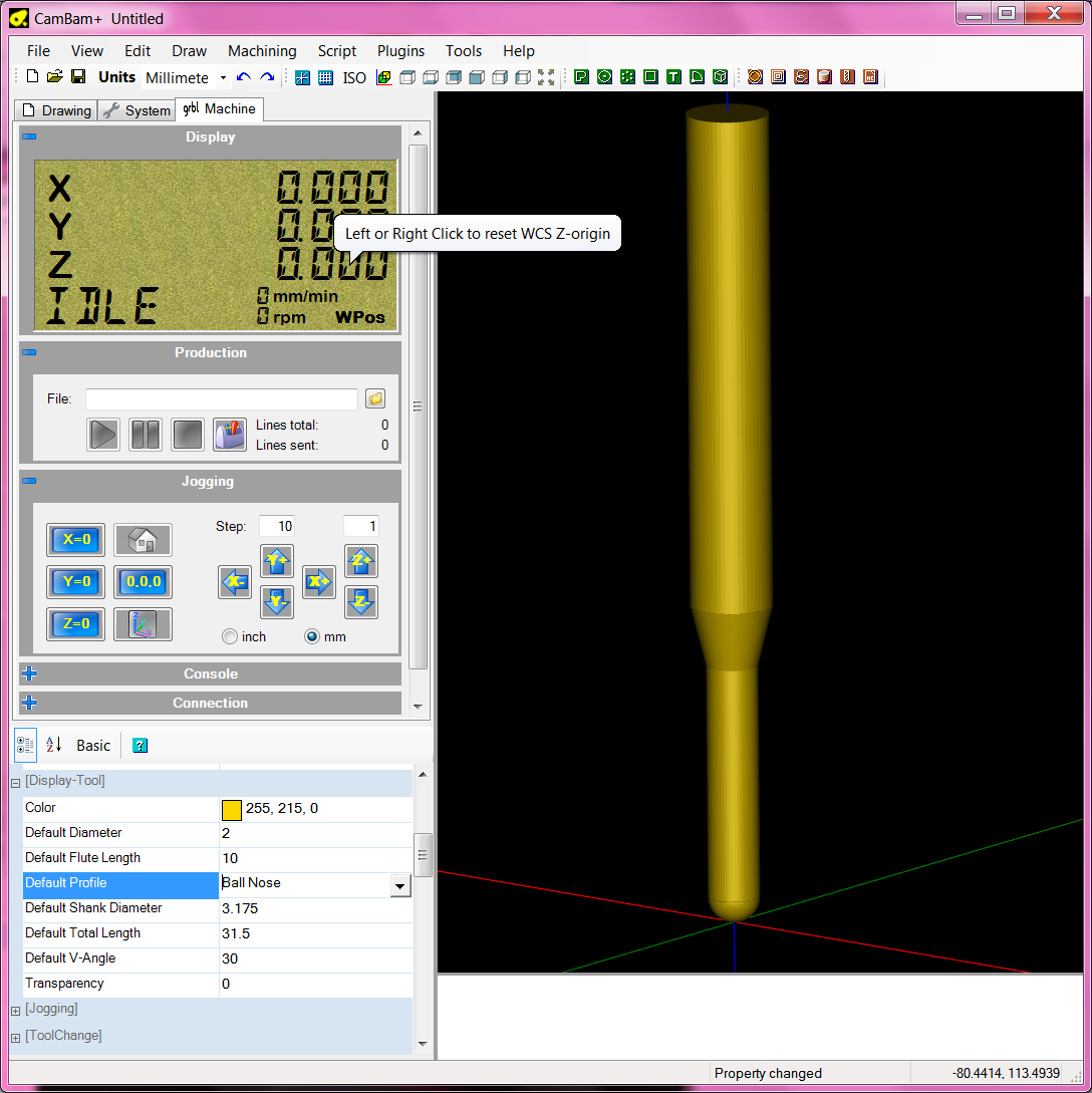

Some pics of the various tools:
(click for the full picture)

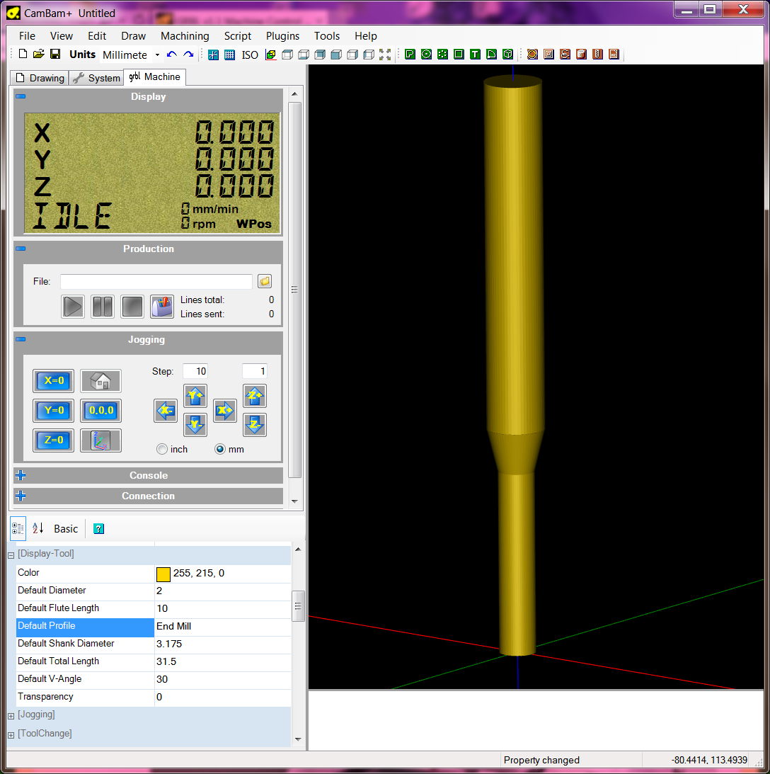

The Endmill.  Note the Cone between Shank and Flute Wink
The BullNose mill.  Note the ball ... Tongue

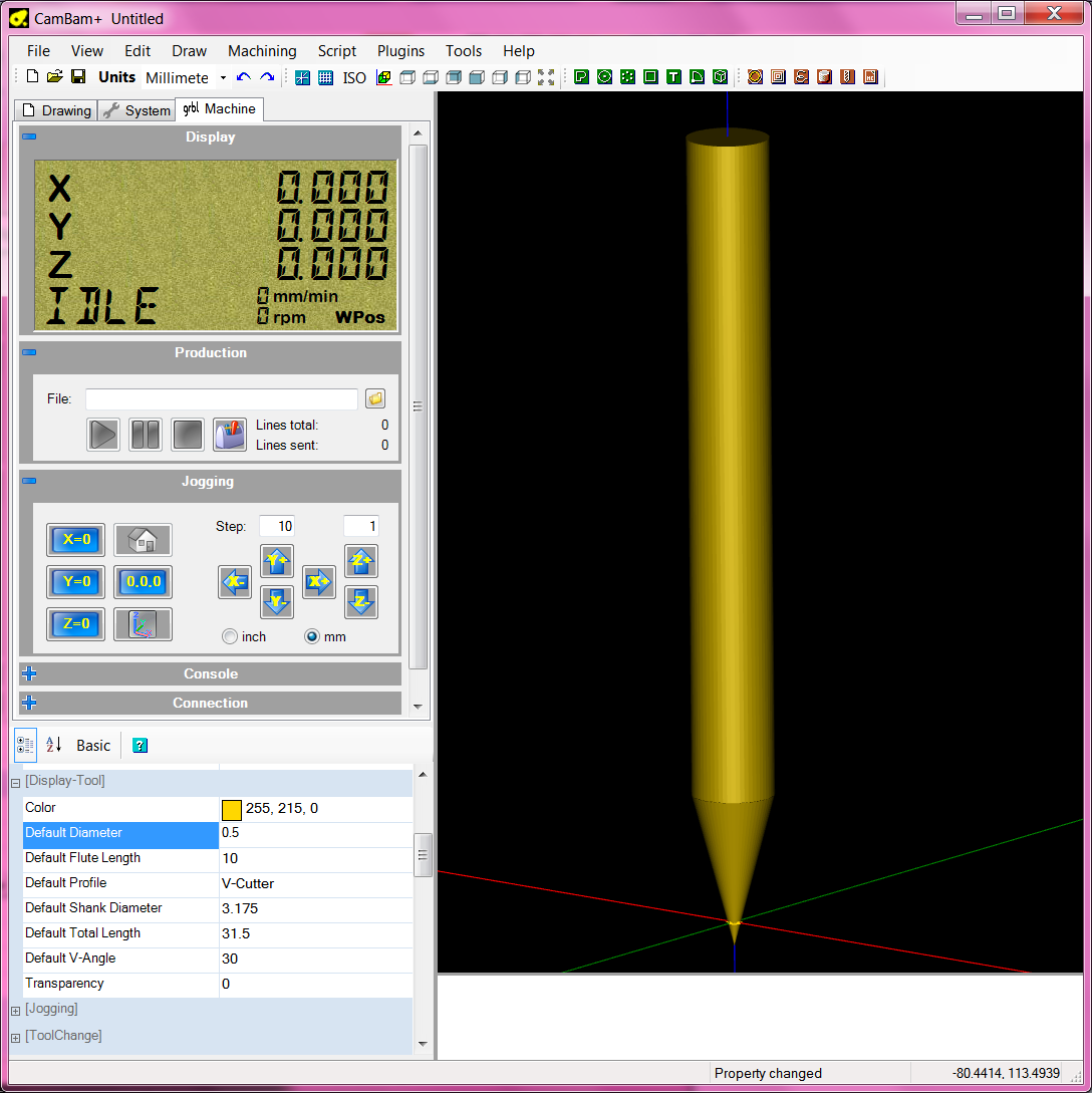

A V-Cutter.  Note the ring around the cone...

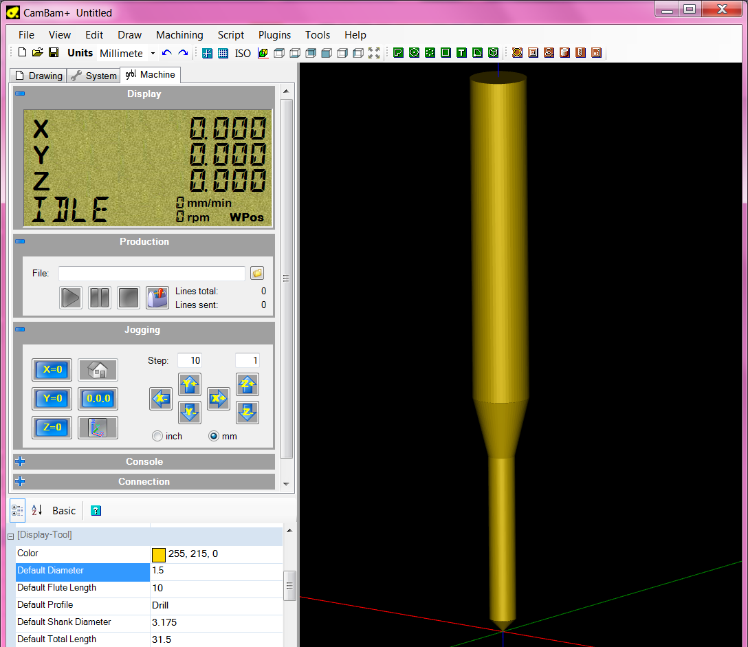

And a drill...

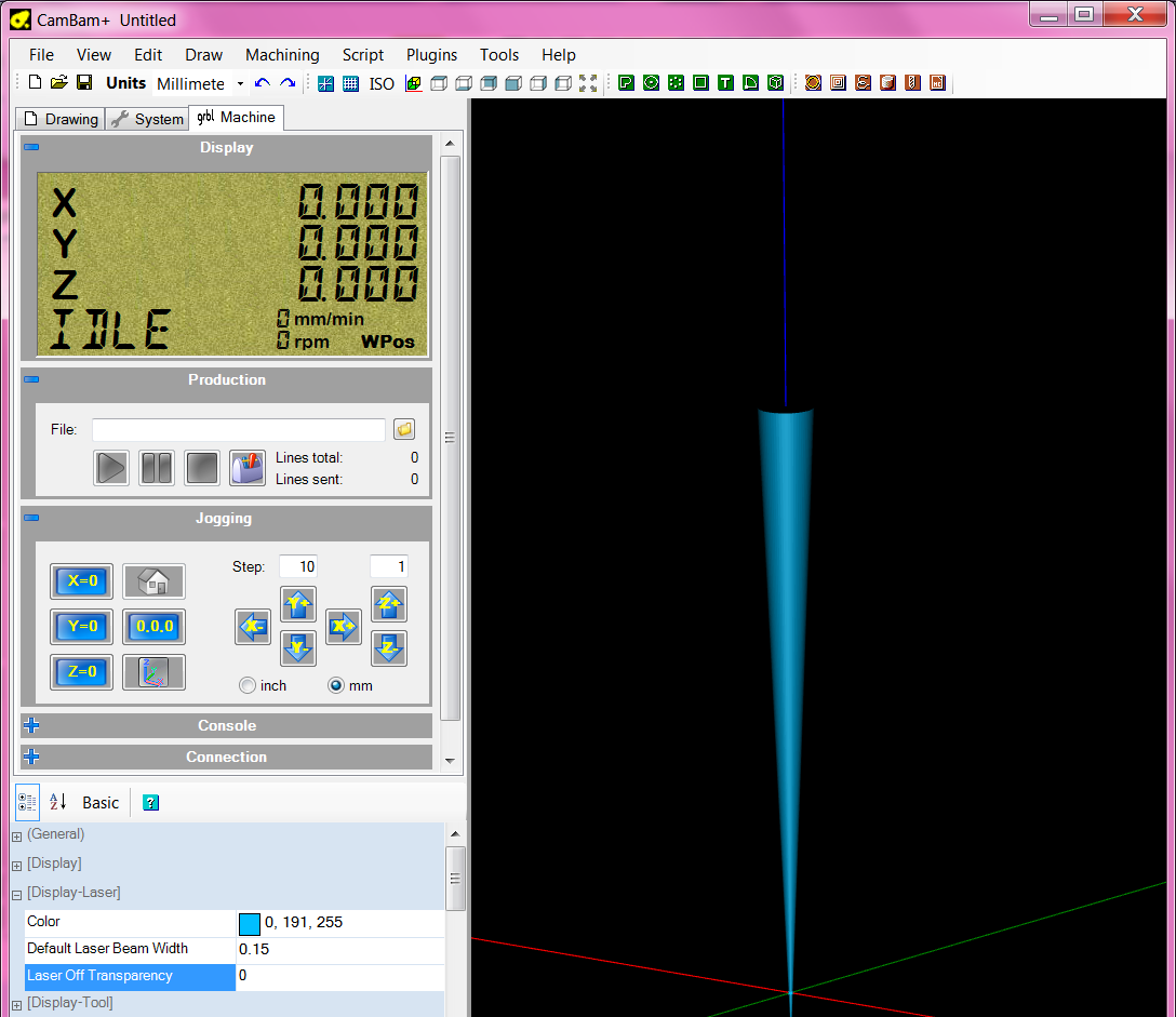

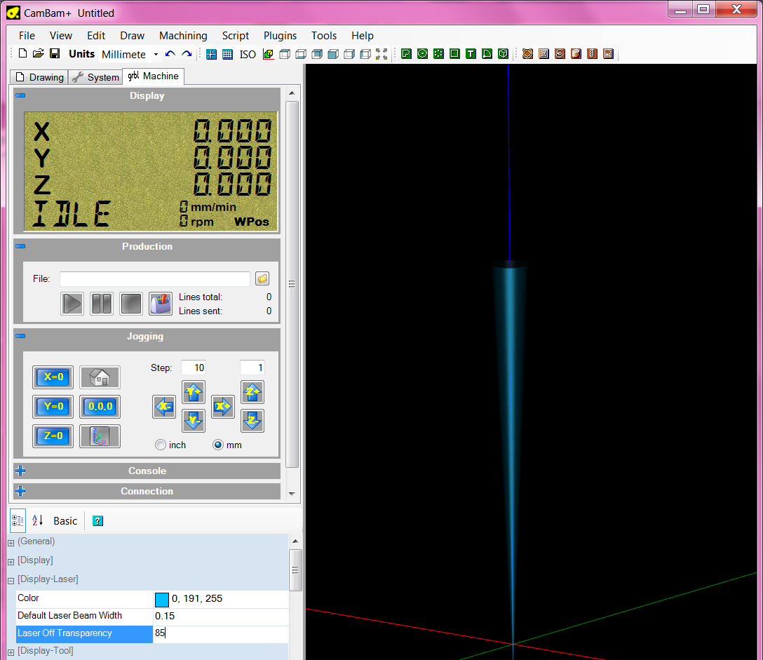

GRBL has a special Laser Mode with which it can control Laser Intensity. Here the intensity (settable) for 'off'
... and here it's full on  Cool
GRBLMachine recognizes wat GRBL is doing to the laser and shows it in the tool.
