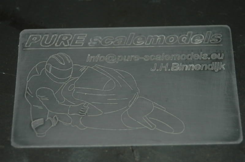

a Polyvinyl engraved businesscard..
First time i machined something with CamBam Generated G-Code.. took me less then 15 minutes to generate, including the text, which had to be postioned properly..

Nice one Arie!  Cool
I was about to hunt down a supplier of that plastic and do some business cards myself next week.
Does that have a laminated surface to engrave through?  I like the metal on black stuff.
If it is, try experimenting with the bitmap to heightmap generator and use a fine V engraving bit.
You only need < 0.4mm Z height differential, but make the Y step quite large (~0.7mm) so
they don't overlap.  This is how I did the 'killer robot' engraving.  I was planning on doing something like that on my cards.  They are quite cool to see in real life and play tricks with the light as you move them.  Can take a bit of playing around to get them just right though.
Text objects need a little work.  There are some bugs like 'Apply Transformations' doesn't seem to work for text and the the alignment options aren't too good.  Curve wrapping would be nice too.

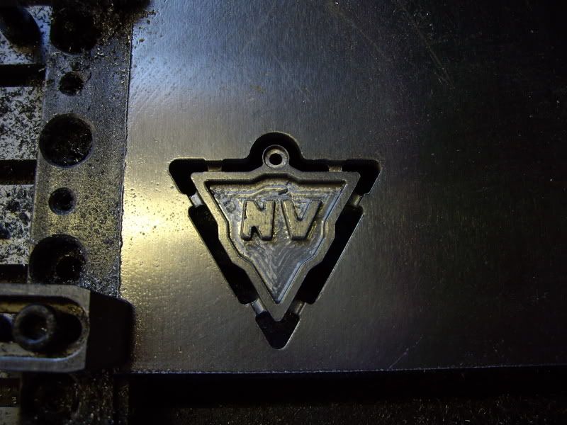

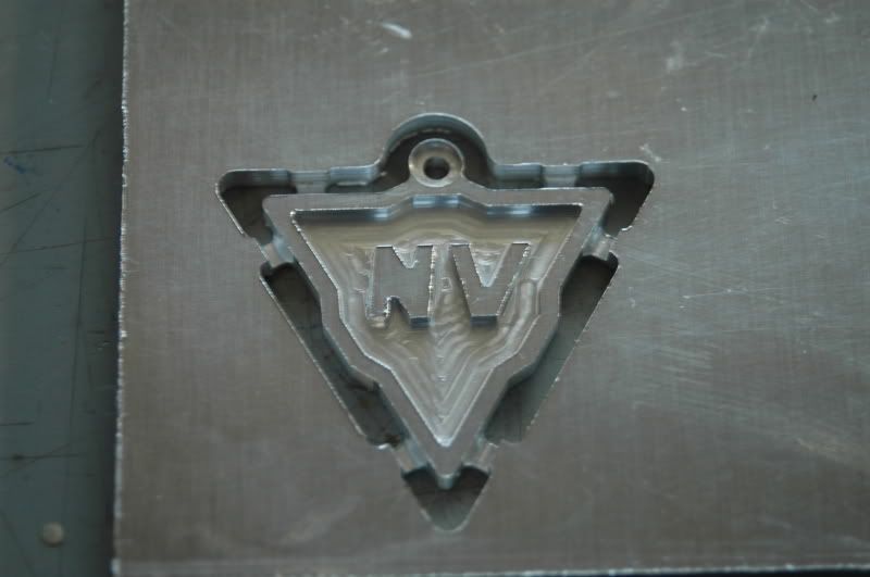

Ok.. some more pokin' around with CamBam.. yesterday i decided that i wanted one of them Flashy keychains... with the logo of Italian Framebuilde Nino Verlicchi, so i looked up their website, picked a logo, traced it in Autocad, exported the DXF ( with some extra layers added for the tabs..)  and went into CamBam-bebop-alula to Generate G-code... took about 30 minutes to program ( joining polylines, making offsets, and programming pockets and profiles.. Uploaded the code to my Psion, hooked that up to the control PC downstairs in the shed.. and hey.. .look what i got 45 minutes later!..
still on the machine..
ready to be cut out...
Lookey!.. my very rare priceless one of a kind aluminium keychain!!
Let me be the first to say.....WOW!  Shocked
I bet there's a few folk who would love to know how you did the tabs.
( Holding tabs planned for CamBam soon! Smiley )

now.. who's a showoff?..  Grin
Tabs?... easy.. Autocad R14.. or any old autocad.. just drew a line and did an offset of tab width.. ( on another layer that is.. ) ..
maybe i'd better write a tutorial?.. auto-generated tabs can pop up on places you don't wan'em..
i traced the logo from an image, mirrored the outercontour around a line just beside the logo, offset that, drew in the tabs, put the lot on layer 1, mirrored it back into place, typed in DXFOUT, gave it a filename, and the rest is thanks to you, and your software..
toolpaths are logical to me, from the center outwards, providing a smooth finish on the outer contour, the inner contours had to be finish machined, but as a toolmaker i ALWAYS finish machine what i make.. so in Cambam, every polyline had an offset one on layer 2...

« Reply #14 on: July 18, 2007, 21:11:00 pm »
I don't know if this achieves the same thing, but in the pocket and profile mops there is the 'Stock' property.
This is simply the amount of stock to leave uncut.  If Stock is 0.2mm and your cutter is 2mm, the first toolpath closest to the geometry will
be generated at an offset of 1.2mm (toolsradius + stock).
If you turn ShowCutWidths true on, it's a bit clearer to see what I mean.
I still can't get over how fast you turned this out!  It would take me nearly that long just to figure out how to clamp my stock.  Cool
